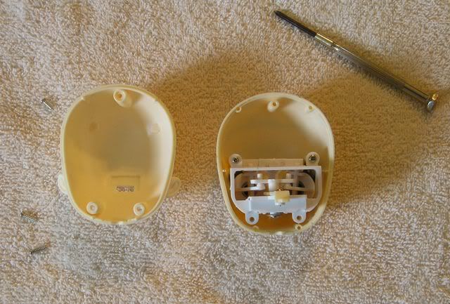

Inside a Dal head/removing chips:
Once the three screws are removed, the inside looks like this:
dal head 1 by TrueFan, on Flickr
Once the eye mechanism screws are removed, the inside of the face looks like this:
dal head 2 by TrueFan, on Flickr

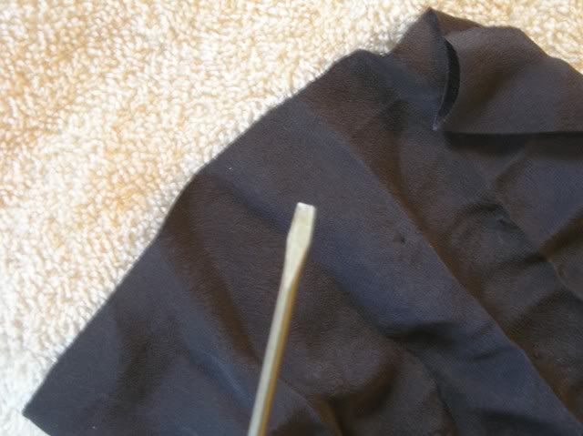

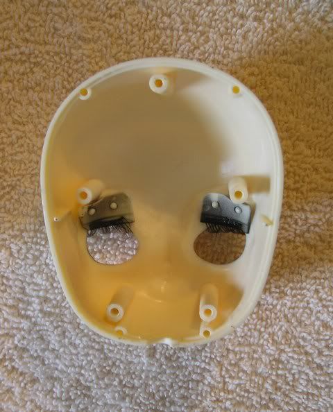

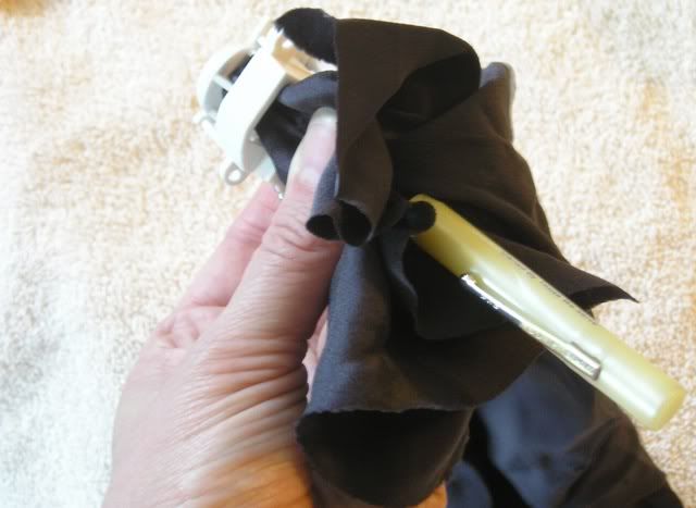

A blunt object wrapped in cloth can be used to gently but firmly poke the chips out from the back:
dal head 3 by TrueFan, on Flickr
dal head 4 by TrueFan, on Flickr

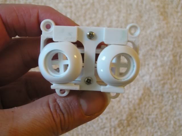

Empty eye mechanism:
dal head 5 by TrueFan, on Flickr

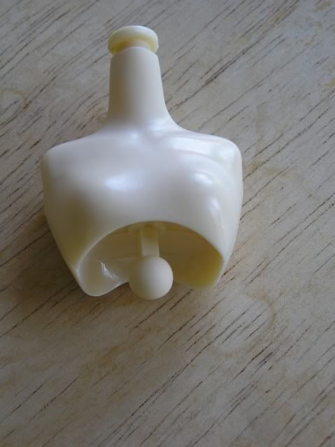

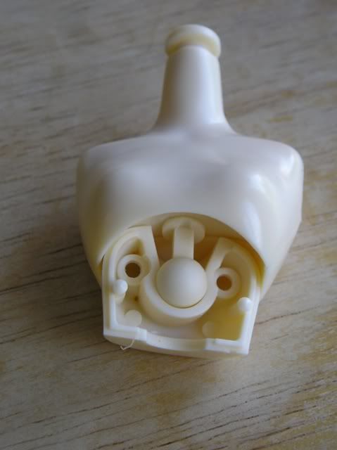

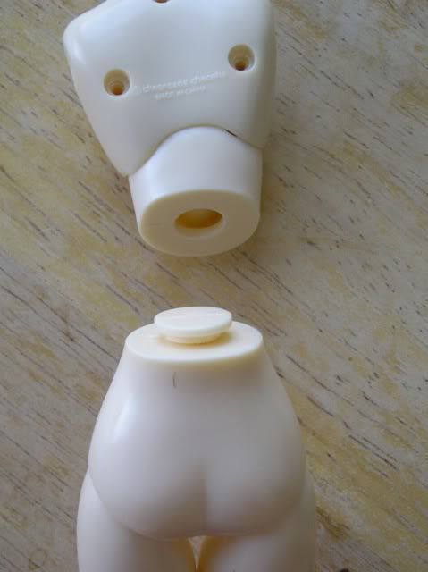

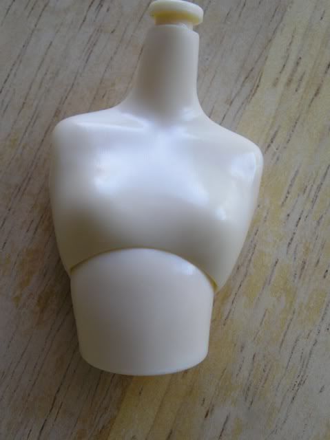

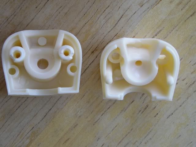

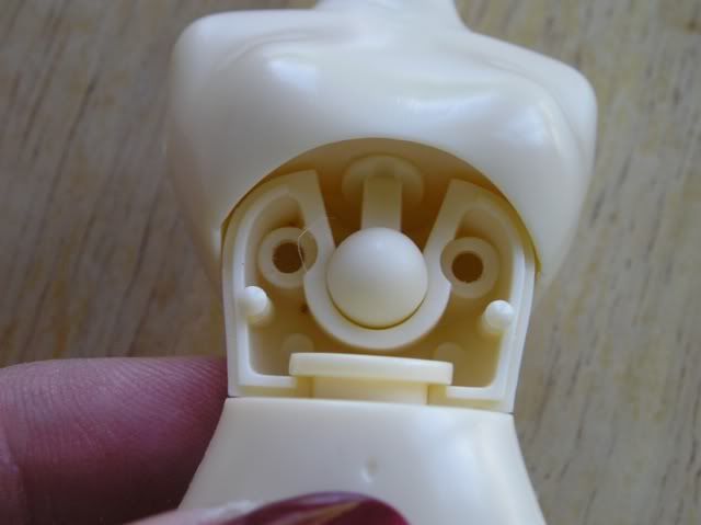

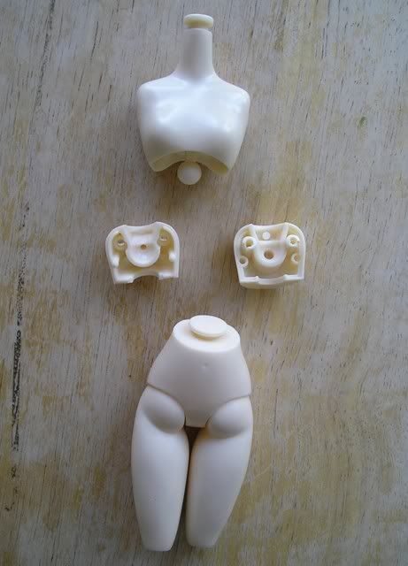

Inside a Dal torso:
dal body 5 by TrueFan, on Flickr
dal body 2 by TrueFan, on Flickr
dal body 1 by TrueFan, on Flickr
dal body 3 by TrueFan, on Flickr
dal body 4 by TrueFan, on Flickr
dal body 6 by TrueFan, on Flickr
dal body 7 by TrueFan, on Flickr
